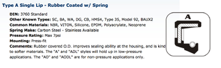

CORRECT TYPE for rear hubs - no dust lip!
outer seal: install with hardside (no spring) showing
inner seal: install spring showing: allows grease to exit near u-joint, not into inner area near brake shoes!
INCORRECT TYPE
You might think a dust lip is a cool idea - but its not in this application: it can prevent grease from exiting and pop a seal completely out if too much pressure is pumped in!
And although great on the transmission for the main driveshafts, a double lip seal is also wrong for the rear wheel hubs for the same reasons stated above.
