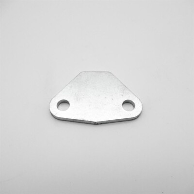

I also was wondering if I just install the low PSI electric fuel pump in the front after the electric 12V fuel shut off valve and then it would be before the mechanical fuel pump in the back, I would not have to disturb the fuel line going into and out of the mechanical fuel pump or the mechanical fuel pump itself. Would that be OK and have other people done that?
That is what I did. If you do end up removing the mechanical pump, here is a source for the blanking plate and gasket

I have had an electric (low psi) pump on the car since I got it. I used it as a "boost pump" when pulling into traffic or going up hills under load. I just left the mechanical one as is. This summer I got stranded when the mechanical one malfunctioned and was blocking the gas. So I removed it and covered with a little plate that was readily available on Ebay.
